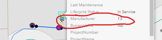

by Anonymous User
Not applicable
This looks to be a known bug  BUG-000127489: Services published to Portal for ArcGIS containing features symbolized using coded domains do not contain the domain description in the Map Viewer when viewing the data legend.
We still have no easy solution for publishing an editable field map.  We had to revert to the old water model symbology as the field staff was used to those symbols.  When editing in field maps they just get a code for asset group and asset type but rely on the symbols to know what they are editing.  If anyone from solutions is listening, a mobile field editing template would be nice for anyone who wants to ever edit in the field...
