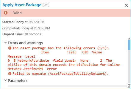

I'm getting the following error when running the Apply Asset Package tool using the Water Distribution Utility Network Foundation v3.2 to a UN in a file geodatabase:
The bitSize of this domain exceeds the bitPosition
Any ideas on what is going on or how to apply this asset package?

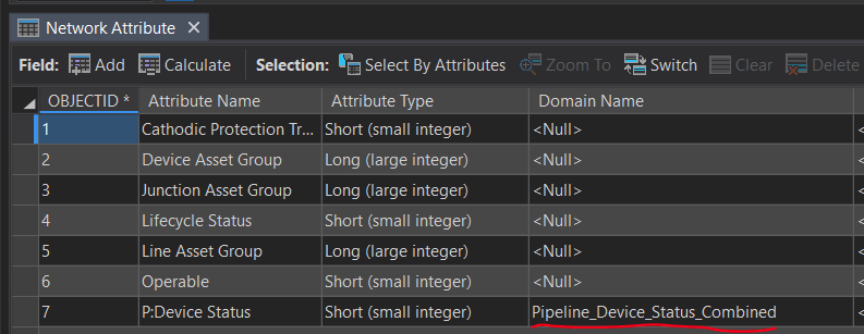

Does the UN you are applying to already have network attributes? There is a limited amount of bits available for inline network attributes, so this error is stopping you from overflow.
Network attributes—ArcGIS Pro | Documentation Has some more information.

Thanks for your reply. Ok, I am just starting my exploration of the UN. Here are my complete steps:
  1. I created an empty file geodatabase
  2. I added a feature dataset and a feature class within that represented my service territory
  3. I ran the Stage Utility Network tool from the Utility Network Package Tools with my Input Geodatabase (1) and Service Territory Feature Class (2) and specified a Feature Dataset Name and a Utility Network Name.
  4. I then ran the Apply Asset Package tool and applied the Electric Utility Network Foundation v3.2 asset package to my new UN with no errors
  5. I then ran the Apply Asset Package tool an applied the Gas Utility Network v2.0.1 asset package to my UN with no errors
  6. I attempted to run the Apply Asset Package tool to apply the Water Distribution Network Foundation v3.2 and got the error I described in my question
I was under the assumption that you could apply multiple domain networks to a UN. I did not modify the Esri supplied asset packages. I guess the number of "bits available for inline attributes" is above my level of understanding at the moment. Is there an issue with applying these asset packages?

Your workflow is correct for applying multiple domain networks to the same UN. Each model has a collection of inline network attributes. The UN only supports a limited number of these.
Without modification, you cannot combine all of these domain networks in the same UN. Looking at Water, you should  remove this domain entry from the B_NetworkAttribute table and then apply the asset package:
by Anonymous User
Not applicable
Thanks. I was able to apply the asset package after deleting that row in the B_NetworkAttribute table. I see in the new data dictionary that this is assigned to the Water Device layer.
Will this have any effect on the utility network (e.g. tracing)? Would I not be able to add another domain network? I have read the ArcGIS Pro Help topic on Network attributes but find it a bit difficult to understand how it all fits together.
