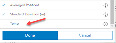

Select the layer that has the added field(s), then click "Select Fields":
Click on the new fields to add the check mark, then click done:
