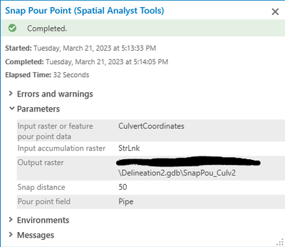

I was able to Snap Pout Point correctly via using StrLnk raster (Stream Segmentation for hydro) NOT Fac raster.
However, my point delineator is not working the way I want it to- it is only pulling up one watershed for all 40 culverts instead of one watershed for each of the culverts. So, I am unsure if my solution is the ultimate right answer.
