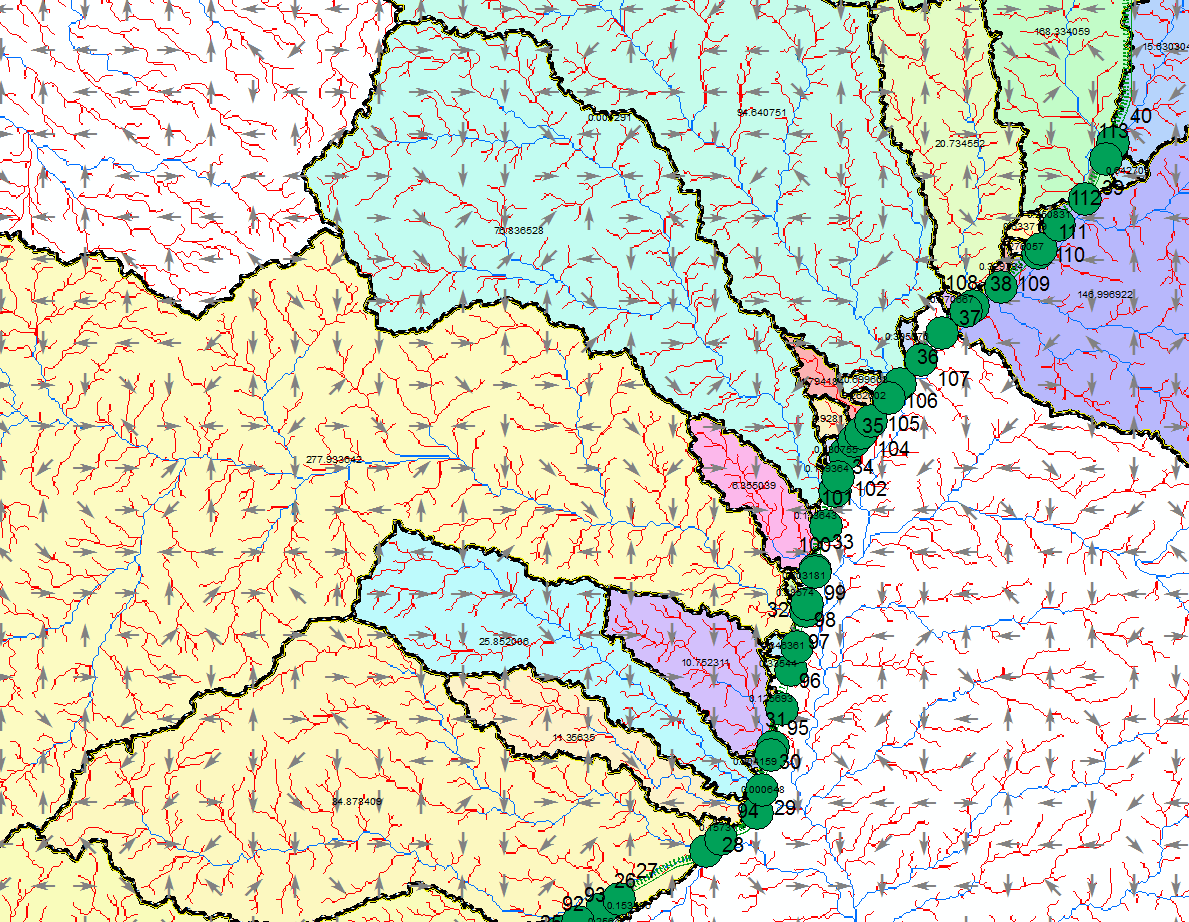

I was able to derive the catchments for each stream crossing. Now, I have two questions:
1.  My question is how can i show flow direction?  So that i can verify the upstream catchments generated are correct.
2.  Is there a way eliminate the white gaps (between pour points and near the road alignment) between the catchments?
I have tried the vector field symbology in Flow direction raster but gives arrows not according to the streams.
I have tried the vector field symbology in the original dem raster and it gives better results but still alot of areas not in accordance with the stream generated.
I have attached a snapshot.
Thank you.
Ron

The screen shot you provided will not correctly symbolize the FDR raster. Were you able to convert the original, unsampled FDR raster to a point feature class, and use arrow symbols rotated by attribute (you'll have to convert the integers to a real azimuth using https://community.esri.com/external-link.jspa?url=http%3A%2F%2Fgisgeography.com%2Fwp-content%2Fuploa...

Yes Thomas, i have tried that too before resampling.  It gives correct result after applying the symbol rotation for each integer representation of direction.  I just resampled so that i don't arrive with congested arrows.

By resampling the flow direction, you are going to get different (and not one of the 8 "legal") pixel values, that have nothing to do with flow direction. Use a symbol weighting scheme that will only show one arrow per 8 pixels with the original. However, completing the Arc Hydro Hydro Network Generation will accomplish the same thing. You really can't symbolize flow direction the way you're trying to.
