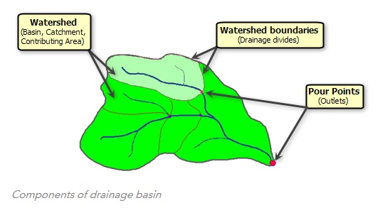

Image source:  Understanding drainage systems—Help | ArcGIS Desktop
