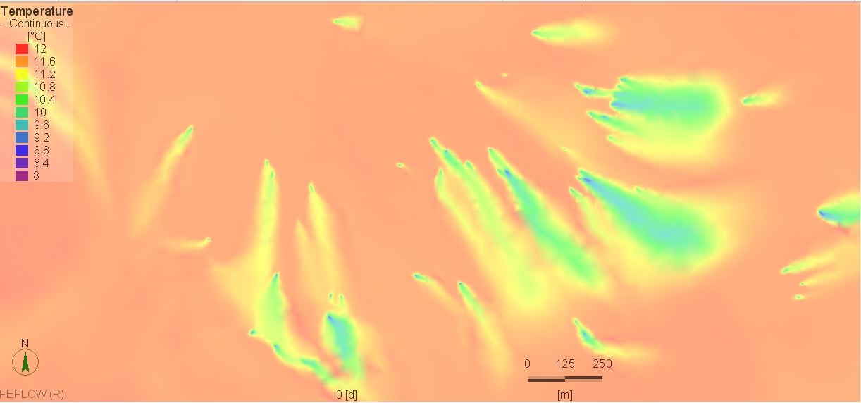

Here the result of a hydrological simulation using the software FEFLOW (finite-element):
Result in Feflow
What it shows is the temperature distribution in groundwater-offstream of geothermal injection wells.
So far so good, result is not only valid, but looks real good.ull

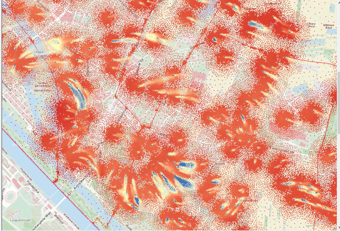

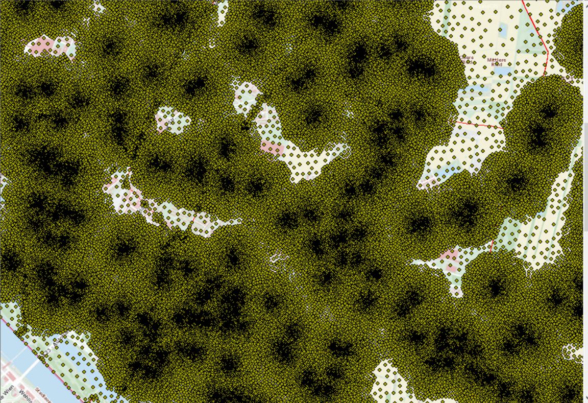

So, it is possible to export as Shapefile, but when importing it to Arcgis, it of course looks like that:
Simulation result loaded to ArcGIS
You might now already know what my problem is....
I now need to find a way to convert it into a raster.
Interpolation (Kriging, IDW etc.) leads to horrible results, I've tried that already. It also seems riddiculous to again krig the result of a precice FE-model....
My way was the tool "Points to raster".
I'm feeling that I'm on the right way, but am still facing a problem, that you'll see in the following screenshot:
After "Point to raster"-Operation
You see, this is no comparison to the first screenshot (FEFLOW-model)
My questions to you now:
1 Is there a way to further edit that raster above, to get full coverage (no gaps) with some kind of nearest-neighbor operation?
2 Is there another way of working with that data in ArcGIS, to create a raster as good as the simulation-result in FEFLOW?
3 What would you do (Feflow allows exporting in .xlsx, .accdb, .dbf, .dxf, .mdb, .pnt, .trp .dat and .shp) but none of those would give me a better feeling...
