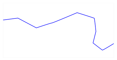

So, assuming I had a waterway feature like this:
I might create a line feature class like this:

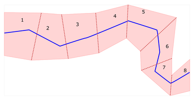

segemtn cutlines in dotted redsegemtn cutlines in dotted red
Then distribute that feature class to all users, either via file or through a published feature service.
Each user can then work in their given segment, and as long as they make sure that their edits snap to the dashed line, they'll know that their work will not overlap with other users' edits.
Taking this a step further, you could create polygons of each segment. The polygon features would represent each user's assigned area, and could even be attributed as such.
assigned zones as light red polygonsassigned zones as light red polygons
It's at this point I realize I've only drawn 8 segments, not 9, but you get the idea.
