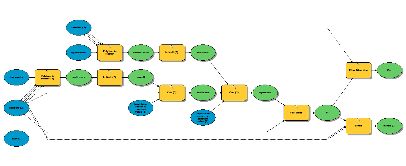

Slightly different note ...  I have recently built my own DEM Reconditioning Model Builder model. I've saved it in a toolbox to my desktop and am attaching it. I've also saved it to Python and attached that. I don't know if this site works for sharing a file like this. Let me know if it does. The attached image shows it graphically.
The reason I built it was because the Arc Hydro DEM Reconditioning tools would crash or something.
If you can download the toolbox you should be able to put it in your project directory like any other file. Then in ArcMap you can open the toolbox and edit the model. You will need to rename most of the files since the path is defaulted to the path I am using. This model seems to do the same thing the Arc Hydro tool does and I don't get errors. It doesn't do it as "nicely" as Arc Hydro in that it does not out the output in a "default" folder named after the .mxd or the the data frame.
I have it go all the way to fdr and I have it calculate a "minus" raster. I then symbolize the minus raster in a light blue to dark blue color ramp and set the zero values to no color (null). This lets me see the location and magnitude of the fills and I can check to see if I need to add to my agree stream layer. I have it calculate the fdr raster so I can use the flowpath tool to poke around and make sure things are flowing where I think they should. This is a helpful procedure in urban areas. I tend to iterate through these steps quit a bit before I move on.
