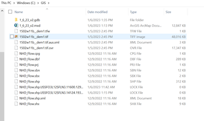

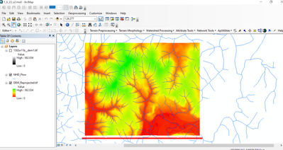

I moved the NHD_Flowline and DEM file and saved the .mxd file to my C drive.
I'm getting the COM error in the Terrain Pre-processing step under Sink Prescreening (though I previously had success here when using a different DEM file).
I did both parts of step 2.

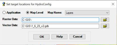

I'm a little unclear on step 3, so I have stopped here and am attaching some screenshots-- Should the raster file link have something else there?
Any advice would be most appreciated.

I'll share the file Target Locations and file structure on one of mine. Maybe a picture will "paint a thousand words".
My project folder is "ArcHydro" and my .mxd is named "ArcHydro", so that could confuse things. But the .gdb is named after the .mxd, not the project folder.
I keep the rawdem raster out in the project folder as well as other layers no part of the Arc Hydro process.
Cheers!
Mark
