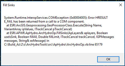

Hello,
I have recently started working with ArcHydro (within arcmap) with our state department to help monitor watershed zones downstream of our surface water systems.  However, I seem to be having an issue getting anything to run.  I tried a variety of processes, but everything seems to end in an error.  I tried following suggestions from other community threads, but nothing seems to be working for me.
I tried:
-setting the extent to the full work space
-shortening the file path names
-deleting files in the temp folder
Yet so far nothing seems to work.  Currently I am just trying to fill sinks in my DEM.
I get this error:
I get similar errors when trying to run other operations.

KyleFuller2
Thank you for the information Mark, I actually found your discussion in my searches previously, and I ended up making my own thread as a last resort because nothing was working.  It's holding up my work flow currently and I am trying everything I can think of along with every suggestion I have found in other discussions but can't seem to find anything that works.  I have even tried running it on other computers and I feel stuck.  Do you know if the DEM has to be in a specific format or if there's any prep I have to do with it beforehand?  The data itself is the only thing I can think might be the issue at this point, but it seems to work for other agencies so I'm a bit at a loss.
