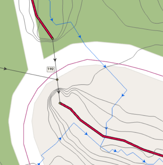

See attached image for old stream layer (bold, red), storm drain nodes and pipes (green dots/black lines respectively), and newly derived channels (blue) doing crazy auto-sink-fill stuff to maintain connectivity.

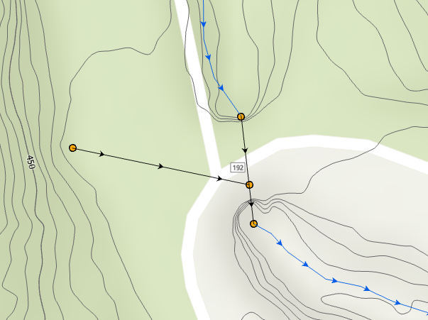

1) Is there a way to use Trace Network, or Trace Attribute(s), to get the elevation value(s) I should burn the pipe channels to? In the image below, for example, say the outlet node is at 400ft, the topmost node is at 415ft, the leftmost node at 425ft, and the central node is at 410ft. If I simply burned the entire network to the lowest value, i.e. the outlet at 400ft, would that be enough to get flow to follow those channels? If not, is there any way to get the incremental values I would need the rasterized channel lines to have at each cell so that flow would travel "downstream" the whole way?
2) Would I need to build "fences" along the edges of these burned in channels to prevent lateral flow from skewing e.g. Flow Acc values? Given that in "reality" there is no lateral surface flow into this burned channel, because the burned channel is really a pipe and the channel was only created to get a nice "drawing" of where stream channels actually go?

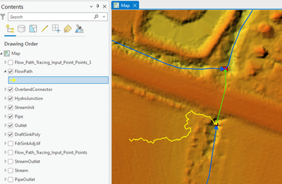

Here is an example of the stormwater process. Pipes are in green and in this example streaminit is the initial stream layer that was burnt in through reconditioning since the input DEM was not "perfect". The inlet to the pipe is a sink. When tracing from the surface, you can see that the flow in yellow ends in the sink point (HydroJunction). When we do a delineation we trace through the network of both pipes and streams to add upstream contribution. We do not burn in pipes since they do not impact the surface flow.
