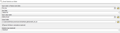

In case you want each record of the culvert feature class to take the minimum value from DEM individually, you could use Zonal Statistics as Table .
You can then Join the field with the Culvert Feature Class based on ObjectID or any other suitable ID field.

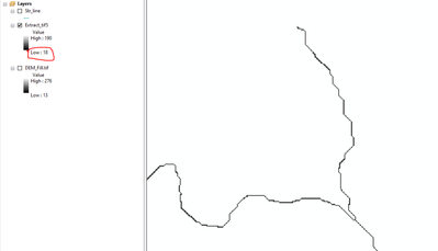

See the image attached, that extract by mask tool worked great. Is there now a way to calculate the minimum value along that raster and apply it to the elevation field for each of the culverts on the layer? I can do it manually it is just time-consuming. There are 175 culverts on this layer, so anyway I can lean up the process would be useful.

Do you want to put same value for all 175 culverts? Use Calculate Field.
Looks like lowest value of DEM along the culvert layer is 596.3. So,
Expression:
596.3
