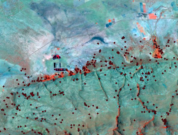

So, that actually worked for the most part. I forgot to mention that there is an old map with river and stream systems and they match up very well. However! There is one huge issue. It turns out..the saltpans in the area (which I guess are very flat, although, I never visited them) have been completely distorted. When I complete the watershed analysis, it essentially, creates a huge (and weird) region where the saltpans are filled. I have asked a GIS specialist at my department and he was unsure how to fix this. my projections are correct, and in so far, I cannot think on how to fix this. I'v attached some photos (and links to photos) below that display my results. I have been pondering about this for quite some time and any suggestions would be incredibly appreciated.
these are the saltpans
[here is the flow direction pic]http://i.imgur.com/ukuOEoT.jpg[/img]

I'm not entirely sure that the flow direction grid is incorrect. The way the salt flats are represented look very similar to how a water body would be represented, which makes sense.  A lot of what was within the salt flats may have been filled in as a depression.
Also, i would look at the year the DEM was created vs the year the imagery was created. It looks like there is some sort of levee or road through the salt marsh that i'm not seeing in the aerial imagery. Can i get a long/lat for the location of this image.

It is only for this region..and I guess, I only really notice that the salt pans stick out when I calculate the flow direction (as it is more pronounced).
Since I am a novice at GIS, I can only give you a datapoint for one of the collared focal species while he is near the salt flats. here it is:
X 737394.8092
Y 7458358.817
I am working in South Africa (WGS 1984 UTM 35S)

How are you sure that the flow direction pattern you are seeing for the salt flats isn't correct?
