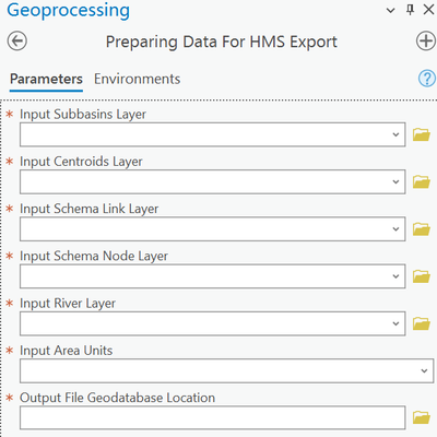

TaoChenalan
Hi Gina,
When trying to use this tool, how we get the "River Layer"?
