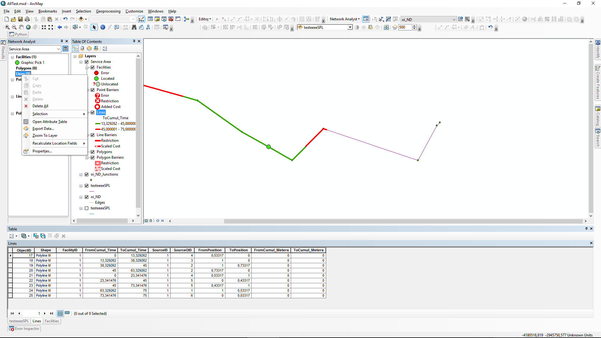

I needed to copy Lines from my Service Area but it's not working. I'm doing what's described here.
But this is what happens:
In both these tests the copy option is greyed out.
What am I doing wrong?

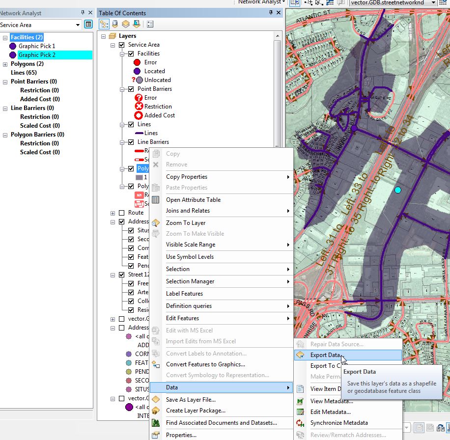

What you want to do is export the data, not copy/paste.  Under your Service Area, right-click on Lines and export.  Note - in this example I did the polygons, but you can do the same for Lines.
Once the export process is completed, you will have a feature class.  You can use that feature class with "Copy/Paste" if needed.
