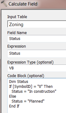

ChristopherThomas
Here is a screenshot of what worked for me using the Calculate geoprocessing Tool in 10.3.1...
In this case SymbolID is a text field and Status is a text field length of 50 that I added to my Zoning feature class.
If you have not already, try restarting ArcGIS to make sure nothing is locked or old variables get cleared from memory.

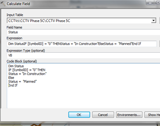

AzaN
Thanks again, Christopher. I followed all the steps you mentioned. Also restarted ArcGIS, but unfortunately didn't work again. Here is a screen shot:
ChristopherThomas
Aza, what Joshua Bixby said below... you only need to put the variable name "Status" into the expression. Post what the error message is if you still do not get that to work.
