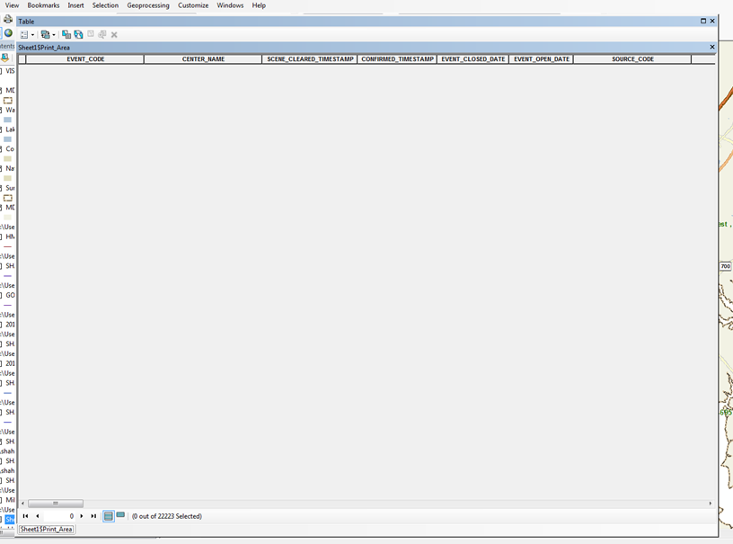

Hi,
I have imported and added data from Excel spreadsheet to ArcGIS 10. But when I right click on the data, attribute table  is blank. It shows that there exits 22223 records but doesn't show them (as below screen shot shows). Can anyone help me with that please? By the way, I have tried to replace all spaces with underscore, but nothing changed.
Thanks, Azadeh

Hi Aza,
A couple of questions. Which ArcGIS 10 are you using? Is it 10.0? Or higher? Also, how did you import this excel sheet? Did you do it through the Add Data button? Was it a drag and drop? Or did you use the Excel to Table tool? Excel To Table—Help | ArcGIS for Desktop

AzaN
Hi Adrian,
Thanks for your help. It worked for me. I use ArcGIS 10.3.1 and I had used Add Data button. As you recommended, I tried Excel to Table tool and it worked very well.

DanPatterson_Retired
MVP Emeritus
Adrian has good examples of where things can go wrong.
fix the spreadsheet first
ensure that each column in the spreadsheet contains one and only one type of data
do not use blanks as null values...be more clever
those column headings are ridiculous, make them simpler and document your workflow if you need to keep track
no space in the filename, the fields, the paths to the data etc.
lastly... don't use a spreadsheet as a database program unless you are forced to
RonFisher
Deactivated User
Try saving it as a Excel 97-2003 Workbook (*.xls) and import that.
