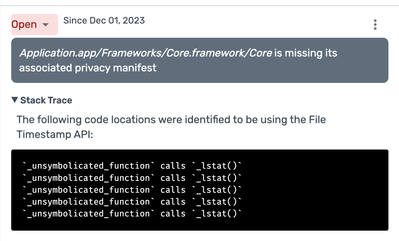

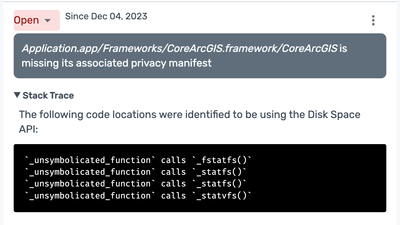

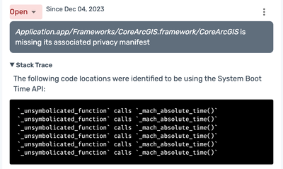

We're using Data Theorem to scan security and privacy issue: https://www.securetheorem.com
Here are result I got from this tool
1. App Store Blocker: Privacy Manifest is Missing System Boot Time API Usage Reason
2. App Store Blocker: Privacy Manifest is Missing Disk Space API Usage Reason
3.  App Store Blocker: Privacy Manifest is Missing File Timestamp API Usage Reason
