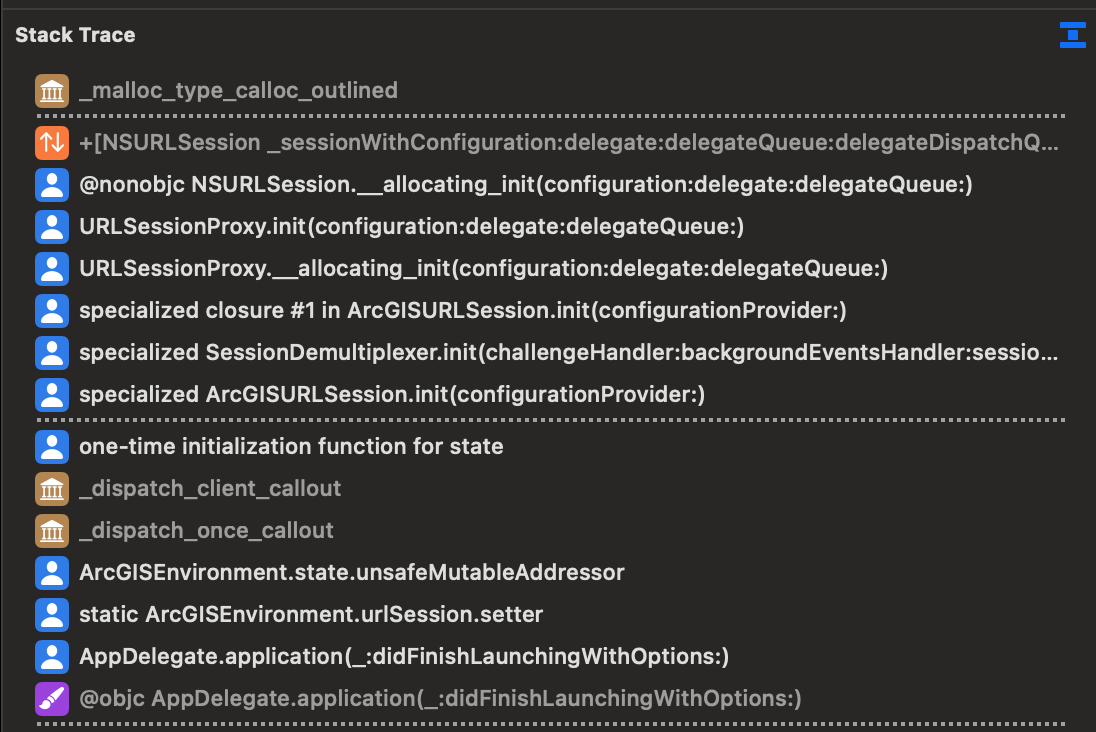

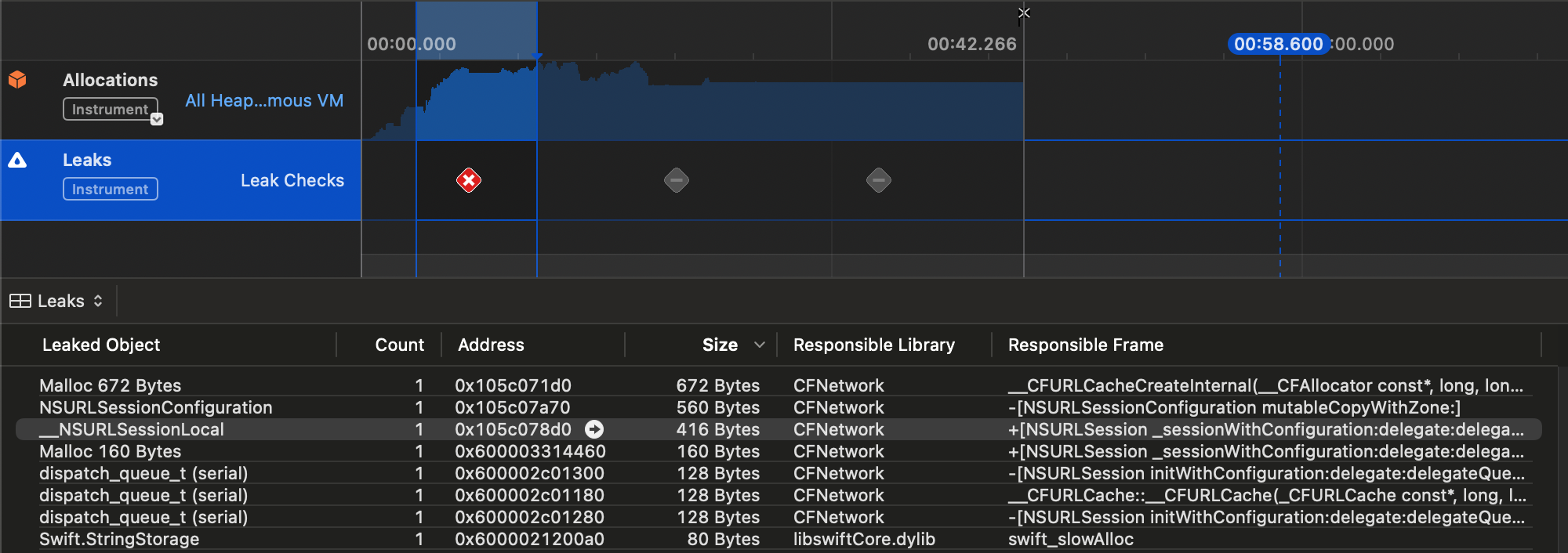

While analyzing the app in Profile mode on Xcode, we noticed that this configuration causes a memory leak each time the map is loaded. Below is the error displayed in the Xcode Profile:
Screenshot 2025-01-20 at 11.54.44 AM.pngScreenshot 2025-01-20 at 11.52.20 AM.png
We would like to confirm with you whether this is the correct way to set up the cache configuration. Additionally, do you have any insights into what might be causing the issue with the map when it loads for the first time?
Does this occur more than once per run of your app? If so, how much memory is leaked in a typical run of the app?

Hi @RyanOlson1 This occurs each time a screen with the map is loaded, which means it can happen multiple times during a single run.
