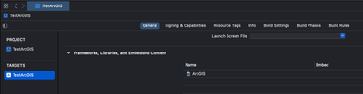

NimeshJarecha
Hi @RTC,
Do you see your framework or ArcGIS framework listed under `Frameworks, Libraries, and Embedded Content` in Xcode project? If not, try adding it.
Regards,
Nimesh
RTC
Yes, it is under the Frameworks and Libraries for the target of my framework
ZacharyKline
Hello,
Can you try making sure the framework is embed and sign and see if that fixes the problem?
RTC
There is no option to select.
The ArcGIS framework is being embedded in a custom framework that is then embedded in the app project, there the custom framework is set to embed & signed.
