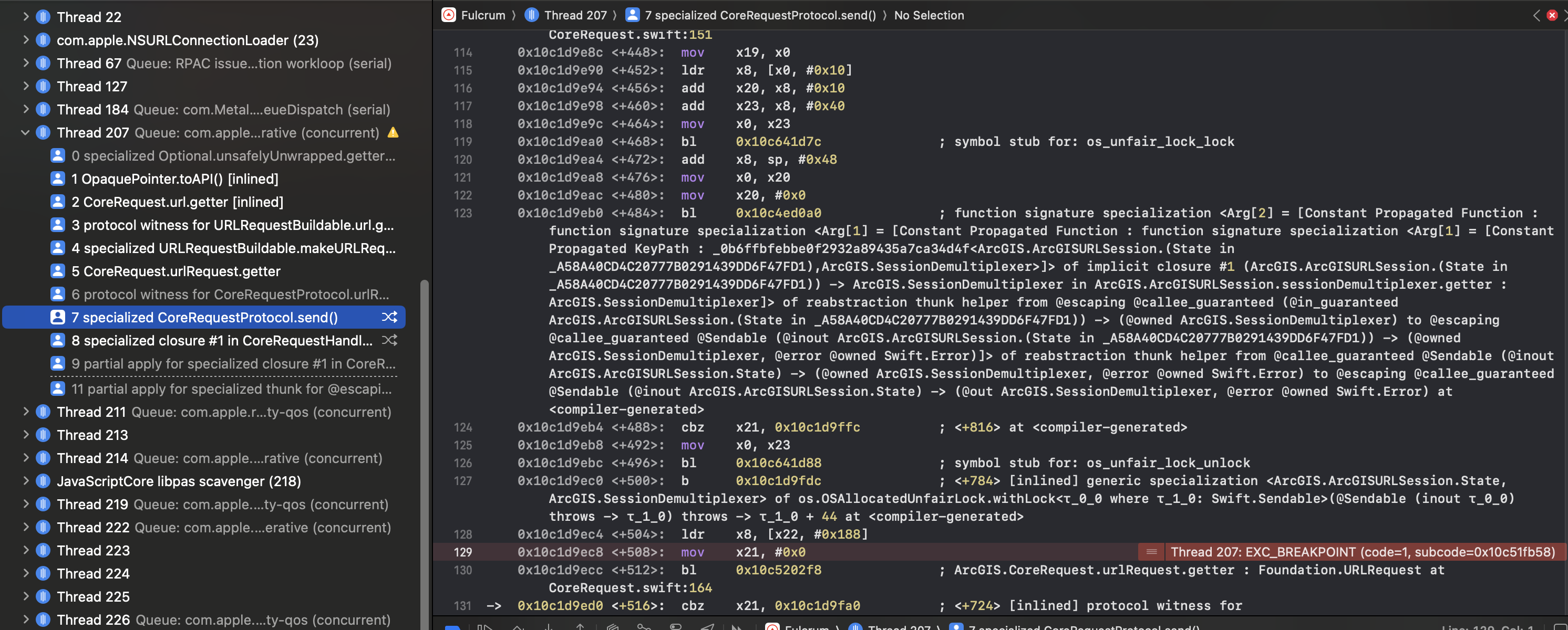

Hello, we have found this crash which occurs when we use the CustomTiledLayer class. We use it to render MBTiles in the map but we haven't found the cause, we are wondering if you have some idea what could be happening, here is an image with part of the stack trace:

It looks like we are somehow ending up with a `nil` URL when we didn't expect to. Can you provide some reproducible code please?
