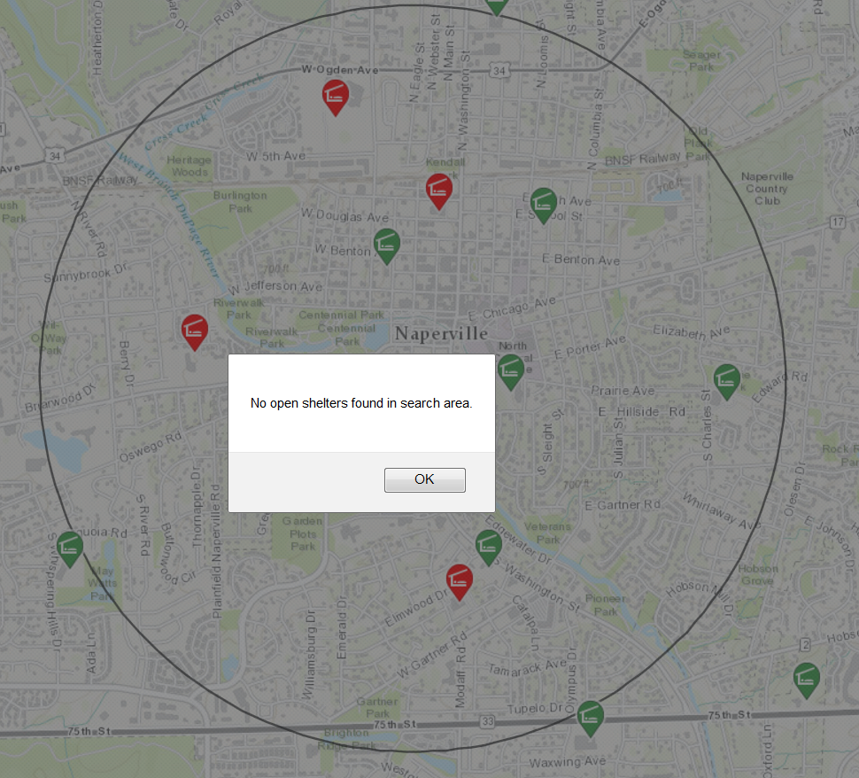

I have tried to test localgov's Shelter locator app. I published it from my Arcmap and was doing all the thing that was mentioned in online help.
However when I tested the application I got following results:
As one can see, there are open shelters in search area. What did I do wrong?
Thanks!

The issue is with the feature layer name in the web map.  You will need to either change the name in the web map or update the ActivitySearchSettings.  For example, change the name of the layer in your web map from:
Shelters - Open Shelters
to:
Open Shelters
