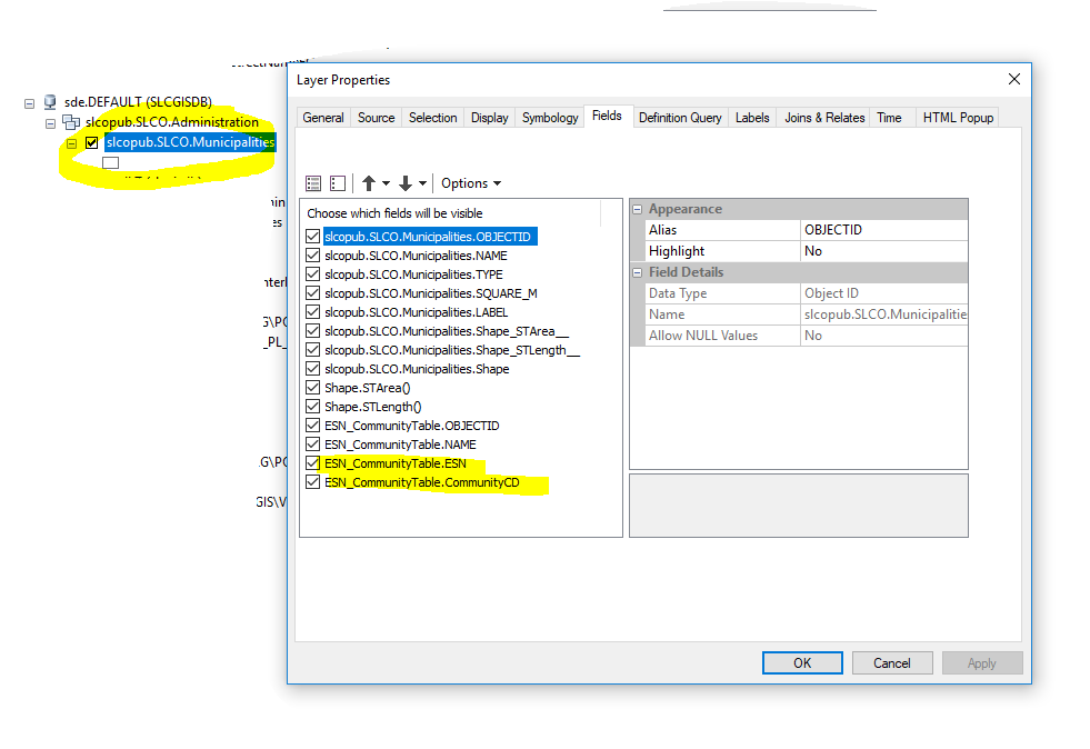

I am trying to update a new point feature with data joined to an underlying polygon feature class.
Background: The polygon feature class has the geometry of city boundaries and resides within an SDE feature dataset. The joined table right now resides in my local c:\ drive, and contains two additional fields that I need for the attribute assistant application.

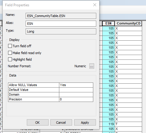

When I initially tested the join in AA, it failed and I figured it did because I referred to the alias field name in the DynamicValue table:
(Both the 'ESN' and CommunityCD fields are from the joined table.)  However, after making the change, the logfile complains that it cant find the field name:

            ERROR: Cant find field ESN_CommunityTable.ESN in table slcopub.SLCO.Municipalities
            Finished: NEAREST_FEATURE_ATTRIBUTES
Perhaps another set of eyes can see what I'm not; is it a path problem to the SDE/feature dataset,?
