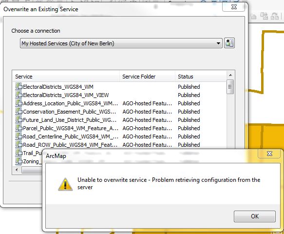

We used the new Solutions Deployment Tool in Pro to deploy the Polling Place "ElectoralDistricts" solution from Esri. It created the hosted feature service as well as the web map / app in our AGOL account. If we want to modify the hosted feature service, we encounter an error when trying to overwrite the service using the ArcMap process: File -> Share As -> Service -> Overwrite an existing service.  The error message is: "Unable to overwrite service - Problem retrieving configuration from the server".
Unable to overwrite service - problem retrieving configuration from the server
This error message appears whenever we try to overwrite any hosted feature services that were created by Pro and/or Workforce (I assume any Esri COTS app). Questions:
