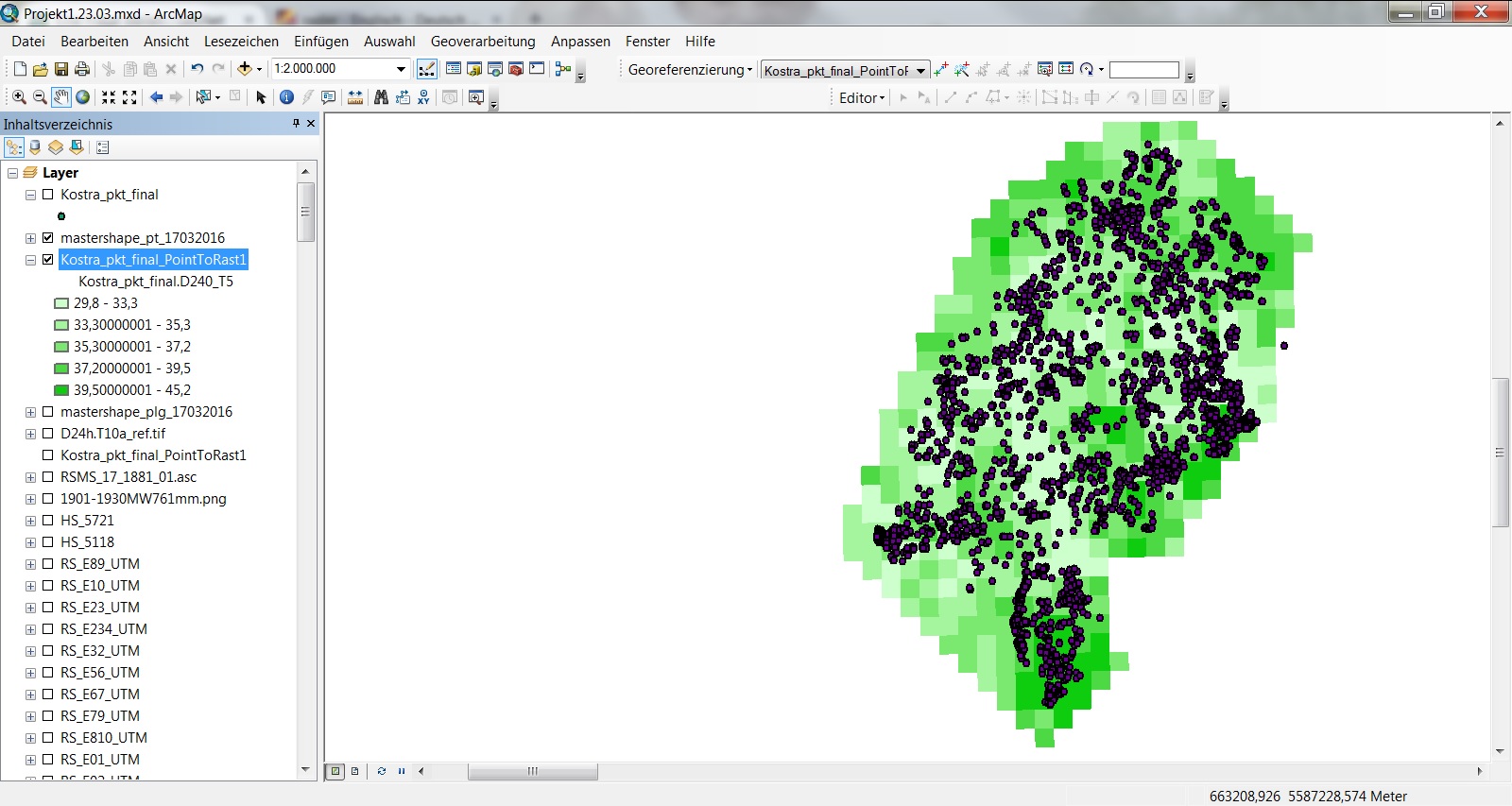

Hey,
i have an Point Dataset (landslides) (mastershape_pt...) and a raster (rainfall) (Kostra_pkt_final...) . Now i want to do some Statistical Analyse. May you can help me
I want to know how many points are located in the raster with the value from e.G 35.3000..1 till 37,2
so that i can say at the end i have 200 points with an value from blabla till blabla  Points_and_raster.jpg
Thanks for your help! Cheers

Extract Values to Points—Help | ArcGIS for Desktop
I am sure you must have missed this one
TillMüller1
@Dan Patterson
thank you it was exact the help i search for. and it works pretty good i know everything is written in the "Help", but sometimes its not easy to find when you don't know what to search for.
