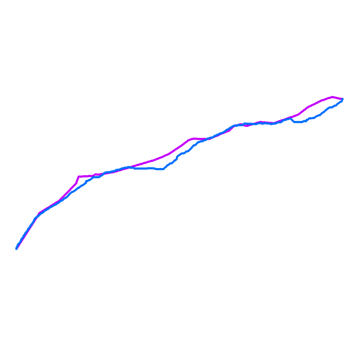

I have one modelled power-line path that I want to compare statistically with an existing power-line path. What I would like to measure is how the model output correlate spatially with the reality. So, no other variables than the XY-coordinates.

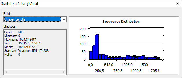

It creates two new featureclasses by projecting lines between points created on one line (based on the step_size) to the nearest point on the other line. This is what is created (using green for short distances and red for high distances):
If you look at the attribute table of one of the results you can run some statistics on the length of the segments being created:
Apart from analyzing the variation between them, it might be more interesting to understand why the real line does not follow the one calculated in GIS. Are there some variables that were not included? Are there features on the ground that were not considered by the GIS calculation since they may not have been available in the data used for the analysis?

Show the paths you have.  Are you looking for deviations of modelled path vs actual path?  I suspect this isn't a correlation in the true sense of the word since causation isn't a play here.
There are a number of factors that you could derive including distance differences, directional changes etc, but there is no reason to suspect that the actual path could be used to 'predict' the location of your modelled path since you don't have an independent and a dependent variable as is required by correlation

what parameters/variables are used to determine your predicted path?  That is the question.
There is a strong 'association' between the actual and predicted path in several areas and not so much in others.
The question becomes, what is in the vicinity of the locations where the paths are similar?  What is in the vicinity of where they are not?
What is driving your 'predicted path'.  Nothing moves by itself, so how do you determine the locations that form the line.
A lot is missing from your description on how the path is derived and why it moves in the direction that it does forming a similar path and length.

Xander that is good.... yes, it is what's on the ground that should be of interest/concern for the predictive model,
