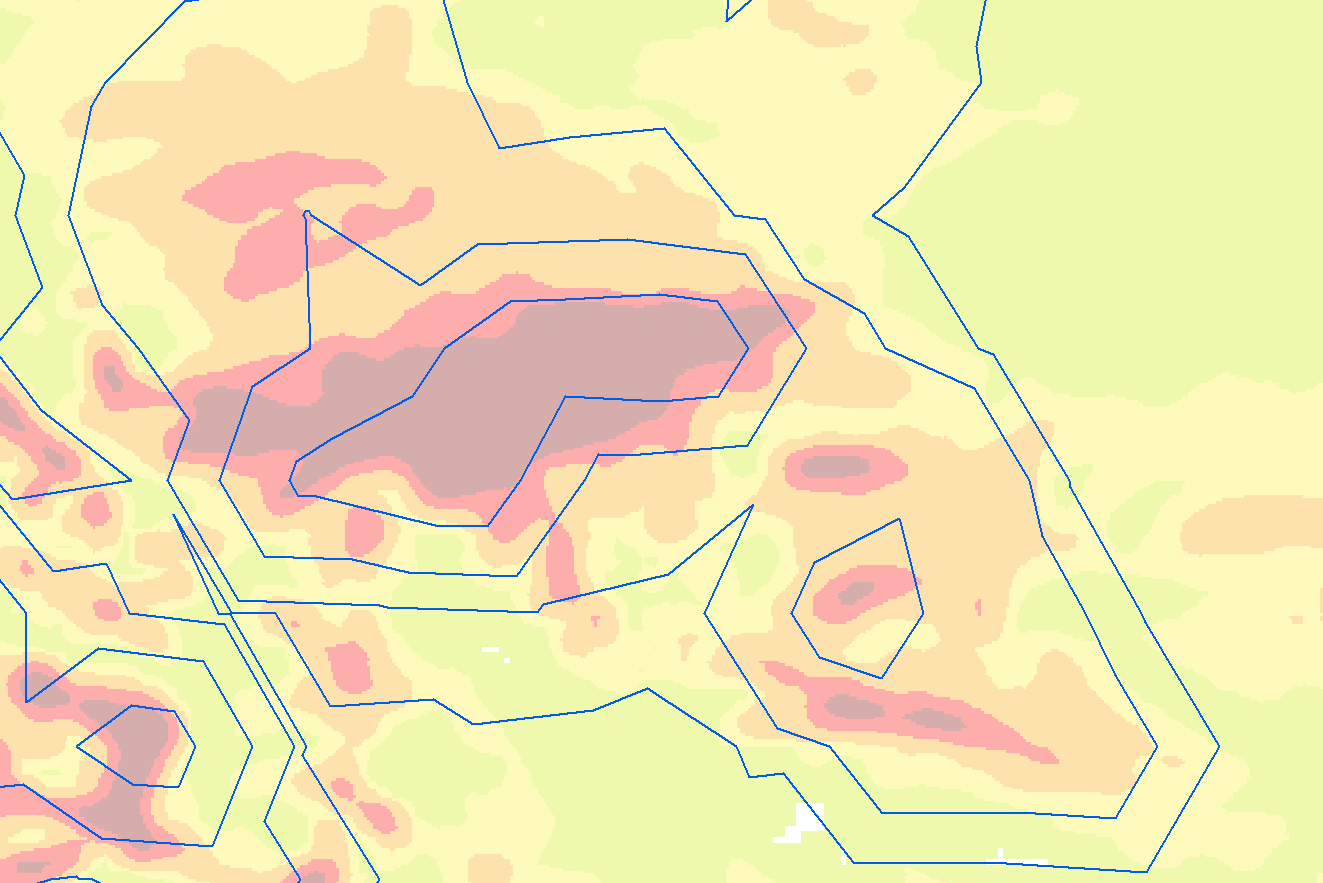

Hi - I'm trying to produce contour polygons out of a Geostatistical Analyst layer. The contour polygons (GALayerToContour_ga tool) are super-generalized and look terrible. This screenshot shows is the resulting contour polygons in blue lines (transparent fill). The grid in the background was exported from the GA Layer (using the GALayerToGrid_ga tool), with the colors classified at the same cut-off elevations used to generate the contours:
My question is: How do I generate contour lines that really follow the data much more closely? Is there some kind of scale or generalization setting in the environments that I'm missing? Here is what I am running:

When I check the GA Layer with the GALayerToGrid_ga, it looks correct.That is the background in the screenshot above.

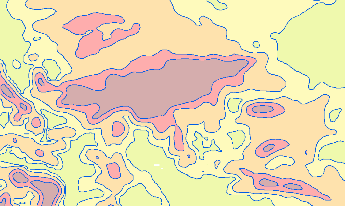

If I run the Spatial Analyst Contour List tool, that creates something much more reasonable. Of course, these are just lines, so they don't meet my needs, since I'm trying to create polygons. Here is a view of those:
Any ideas on how I can create polygons with boundaries that look like the lines in this screenshot? thanks!

The first image that you show, please can you show the contour lines on the GA layer and not on the exported raster. From what I see is that he lines and the raster don't line up.
Make sure that the GA layer is rendered in presentation mode and that the contours are also exported with presentation quality.

When I add that layer file to my map, I am starting to get a better sense of the problem. Here is the default "Filled Contours" symbology, with the contour lines borders drawn in blue (transparent fill) over top:
They don't really line up, but I'm seeing the problem. If I switch to Grid symbology, it gets closer:
If increase the number of grid cells it uses to draw, it gets closer to looking like the grid I saved out, but doesn't really explain the contours generated:
In the end, I'm not sure this really gets me any closer to creating beautiful contour lines. Any idea where to go next? Is there some kind of cell size, resolution, or tolerance setting that I can adjust to make the contours higher resolution?
