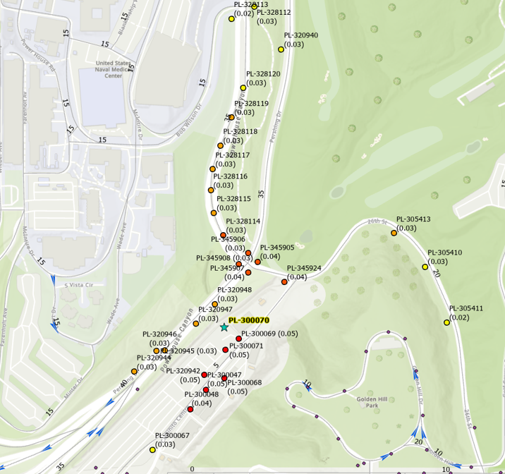

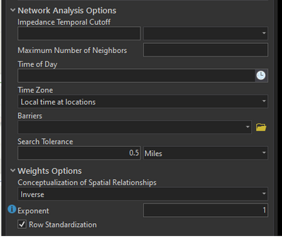

Hello, I am new to these spatial weights matrix builds so am probably missing something. I have been using the Build Network Spatial Weights Matrix tool using "Inverse" for Conceptualization of Spatial Relationships of street light poles.
I then use a GP tool to convert the matrix to a table, select for a certain sample point + it's neighbors, then join them to the point feature class to visualize the results.
I am seeing mixed results in regard to weights; it appears some neighbors are weighted, and some are not:

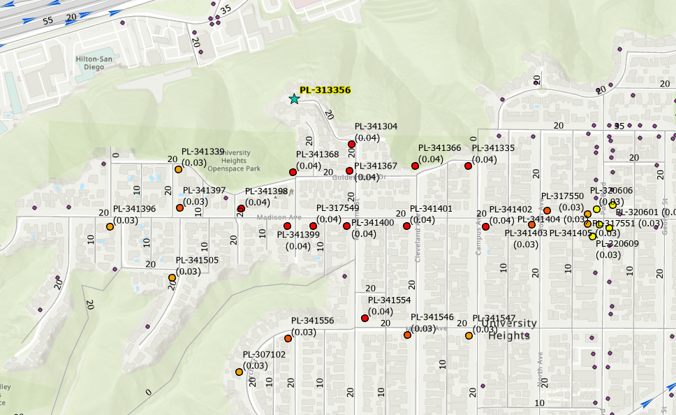

Weighted results, neighbors for sample point PL-313356
Weighted results, neighbors for sample point PL-300070

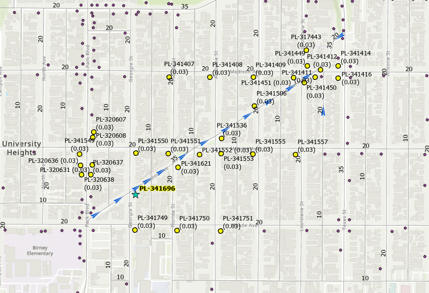

Non-weighted result, neighbors for sample point PL-341696
I see results like above when using the "Fixed" version of Conceptualization of Spatial Relationships... any idea why some results appear Fixed and others appear Inverse/weighted when using "Inverse"? Hope this makes sense.
