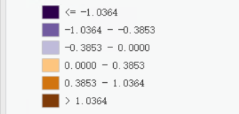

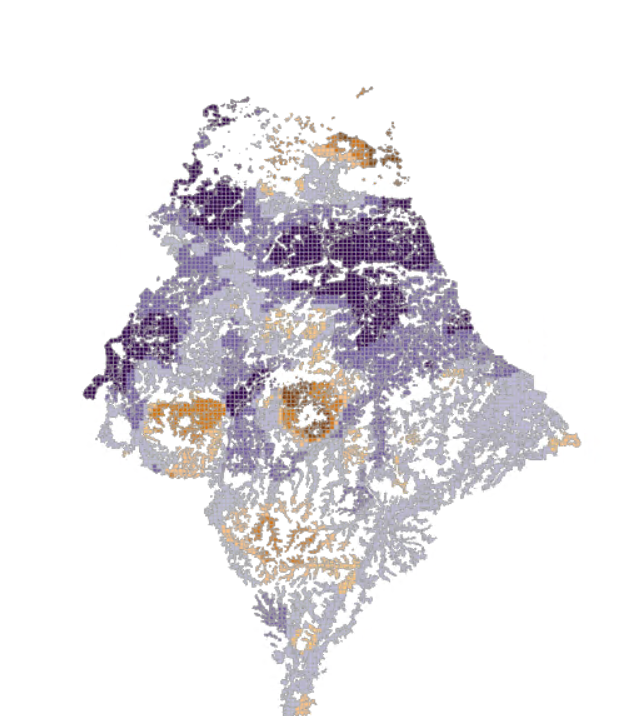

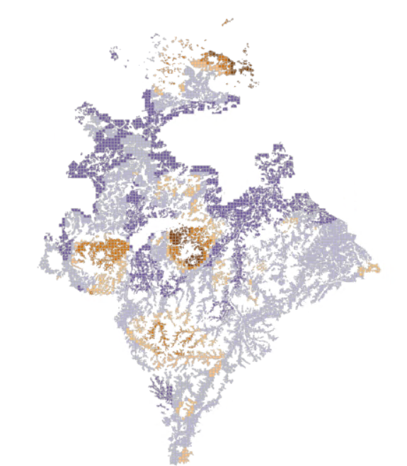

When using ArcGIS Pro 3.0 or 3.1, if the coefficient value in the output is less than -1.0364, it will not show up in the map.
When using ArcGIS Pro 3.2, the output is displayed correctly, notice those dark purple areas in the below picture is not showing up in the above picture.
