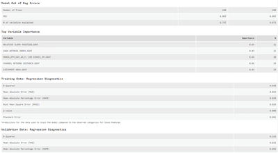

I am using 5 rasters in my model to predict a soil property point data. I am wondering what it means when you have a low variance explained 22% (model bag of errors), however in my training data regresssion diagnostics, the R2 is 89% and the SMSE and SE are also low.  Also, when I look at my residuals the model appears to have predicted very well.
CatherineMcSorley
Hi, it sounds like your model might be overfitting to the training data. So it looks like it's doing a really good job on the data the model was trained on, but then the model won't perform well when predicting to new data.
There are a couple of ways to avoid this. Start by looking at Validation Options accordion in the forest-based and boosted classification and regression tool, and make sure there is some data set aside for evaluation (Training data excluded for validation %). Then, in the output, you can evaluate your R^2, errors, etc. on both the training and the validation data. If the metrics are much better for training than for testing, your model is overfitting.
There is a checkbox in the tool to Optimize Parameters. This will choose the parameters (such as tree depth, etc.) that gives you the highest, say, R^2 specifically for your testing data. See more here: https://pro.arcgis.com/en/pro-app/latest/tool-reference/spatial-statistics/how-forest-works.htm#:~:t...

  1. If my training data and  validation show R2 values that vary greatly as shown below for Nb soil property, does this mean that  Forest Based Classification and Regression does not work for this data and I should just use interpolation such as Kriging?
  2. Does the low % variation explained (8.7% and 9.8%) in the Model Out bag of errors indicate that my rasters have very little relationship in explaining Nb and again therefore the model should not be used?

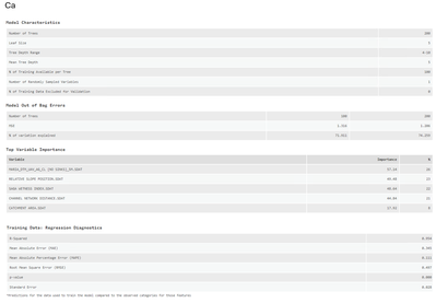

  3. What does the values of importance indicate in the Top Variable Importance Table?  They range from .02-.03.  The values are very low when compared to Ca soil property which has a range from 17-57.
  4. Ca also has a high variance explained in the Model Out Bag of Errors, therefore I am assuming that this models rasters have a strong relationship with Ca?
