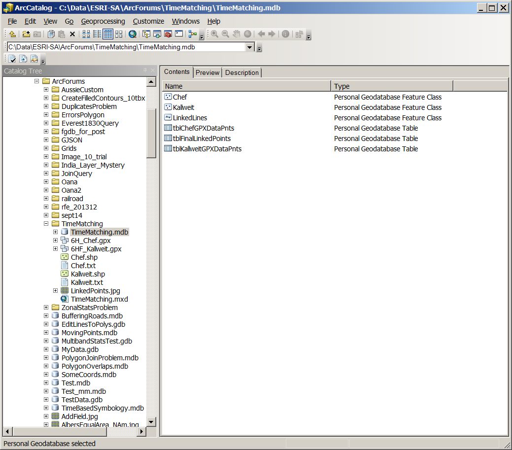

This is the view of the TimeMatching.mdb in ArcCatalog.
The lines are the feature class LinkedLines. You should be able to see that and load it into ArcMap.

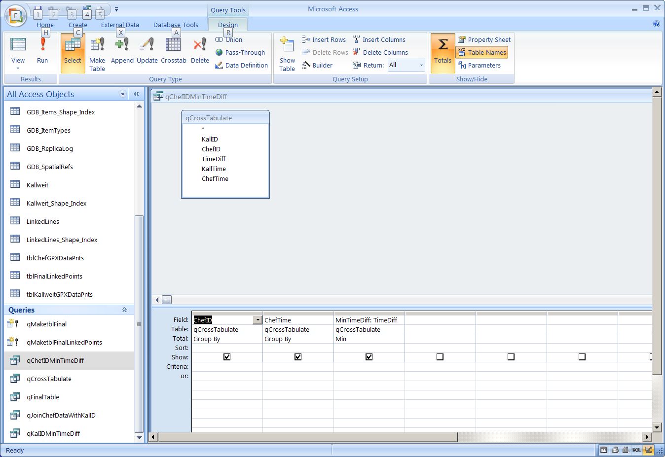

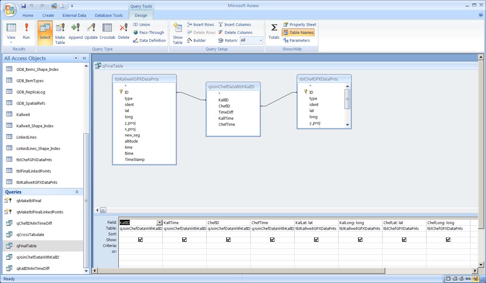

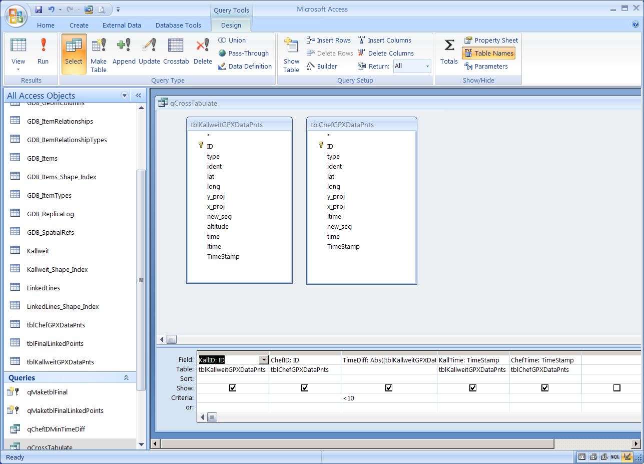

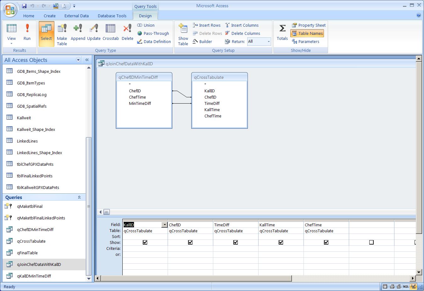

We are joining Chef (dogs - 2250 records) back to Kallweit (owner - 1306 records).
First we create a query which "joins" the 2 input tables (tblChefGPXDataPoints @ tblKallweitGPXDataPoints).
Because there is no "join" as such, this just creates a very large / long cross product of the 2 tables.
Then query 2, summarises this query across the ChefID and the minimum time.
Then query 3, joins this back to the first (a bit circular) so we can find the IDs on both sides.
Query 4, then uses this as a join in between the original input tables so we can get back to the Lat/Longs on both sides.
Hope this makes some sort of sense.
