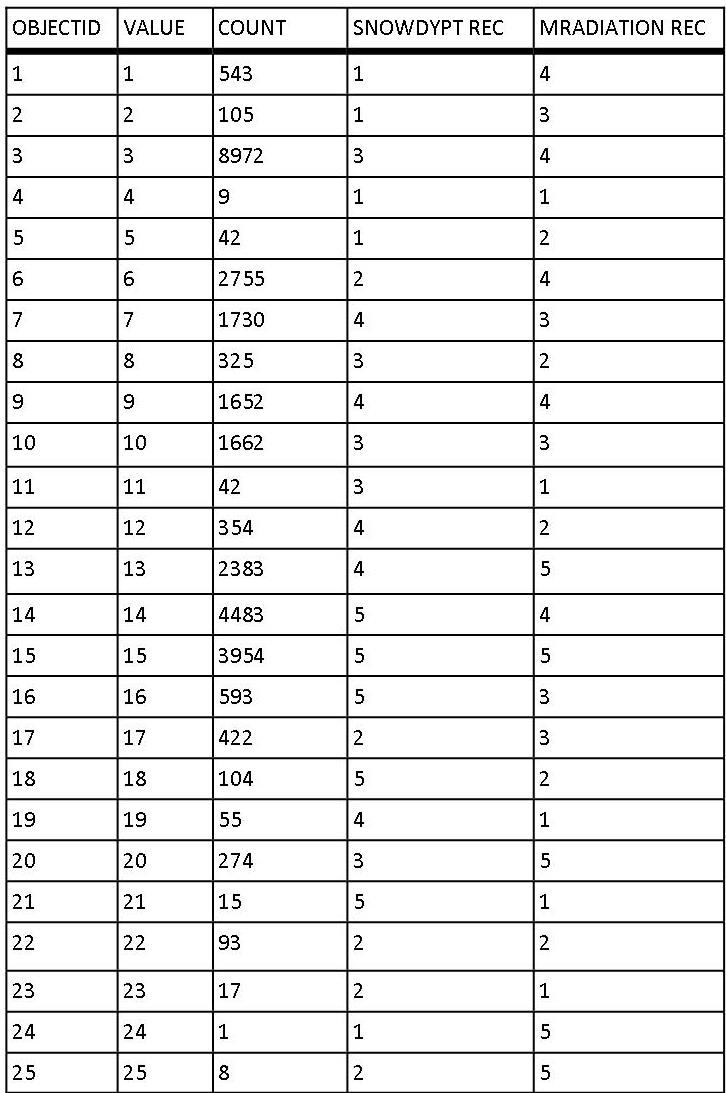

Hi again, Dan.
The Reclassification and the Combine tool is working well and giving me some
interesting tables. The only problem is that I'm trying to make sense of the
values from different combination and tables to get some Albedo values. I am
attaching a sample of the combination of Snowdata and Radiation for some
suggestions.
DanPatterson_Retired
MVP Emeritus
the first class (value 1) ... there are 543 cells that are the combination of snowdtptrec and mradiationrec (whatever those) represent.  etc etc
some times it is better to make a table out of them  like a pivot table
                 snow typ class
rad cla        1      2      3      4      5
             2                                    8       (your last class)
             4    543                                       (your first)
fill in the matrix
