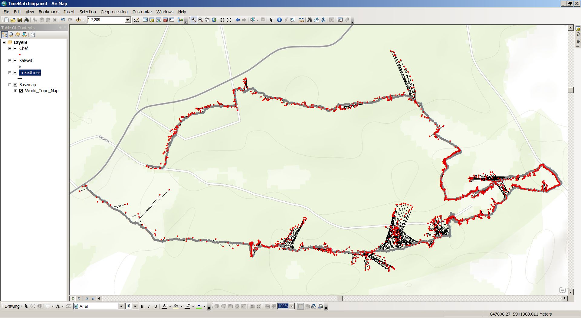

Thanks for the data, I had a fiddle with it.
First I used the dnr garmin program to read the gpx track files to points (as text & shapefiles).
Then I created a personal geodb (access) and loaded the data from text.
Unfortunately, the time stamp info in each file (ltime), won't automatically come in as a time/date field, have to first import it as text, then update it into a newly created TimeStamp field of time/date type. Confusing huh...
As I said previously, you can create a series of queries which join one file to the other based on a minimum time difference between them.
Have a look in the mdb file zipped attached.
From the matched table I used the XY table to line tool to create the joining lines. Then added a distance field, changed the projection of the df to UTM32N and calculated a metres distance / length.
Hope this works for you.
