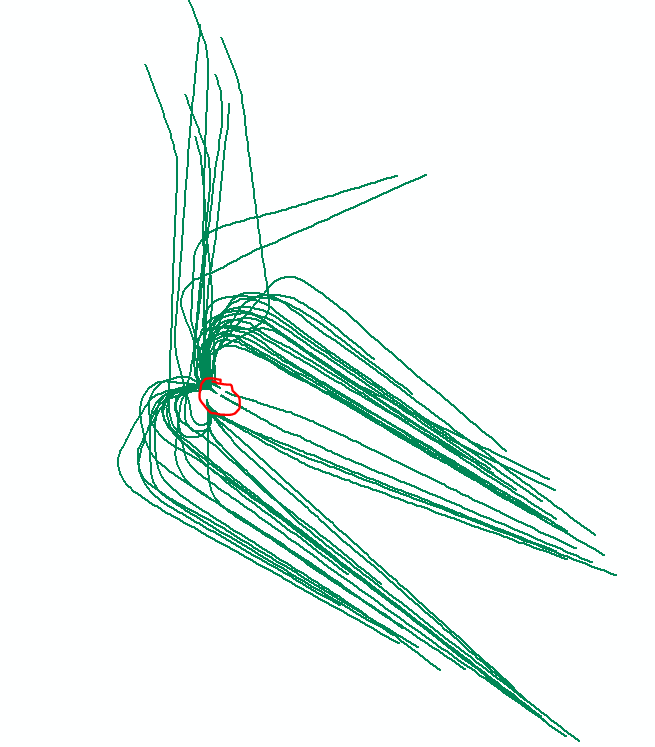

I want to create a route from this line file but also have the ability to define the start point (somewhere in red area) so that the routes all start from the center and move out to the edges.  The coordinate priority parameter only allows for lower left, upper right etc.  This part of the documentation seems to suggest that you have the ability to control the start point but I can't see how that's possible.

I was able to get the desired result by creating "From" and "To" fields in my line file and setting those values as you stated above and then selecting the "two fields" in the measure source.  This way it bypassed the Coordinate priority and forced the start points at the actual start of the tracks.  I don't think it's necessary for me to use the calibrate route at this point.  I'm just beginning the work on a large amount of data but this seems to be the answer I was looking for.  I can then run the routes through "generate points along lines" and locate features along routes to derive my z values so that I have elevations at specific measurements along each track.  I certainly appreciate the feedback!
