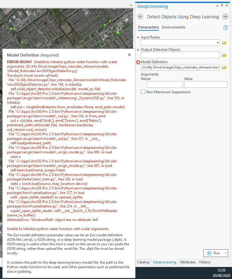

I trained a Deep Learning model with the arcgis.learn module from the ArcGIS Python API for object detection of roundabouts on an aerial image. The model is trained from a SingleShotDetector model by using image chips that were exported as Pascal VOC Rectangles.
When I try to use this model to detect objects, I get an error when selecting the .emd file for the Model Definition. I have already reinstalled the complete Deep Learning framework with the commands specified over here: Install Deep Learning Frameworks, but it is not solving the problem.
I use:
ArcGIS Pro 2.6
Tensorflow 2.1.0
Pytorch 1.4.0
How can I solve this???
by Anonymous User
Not applicable
This problem was fixed after upgrading Pytorch from 1.4.0 to 1.6.0.
