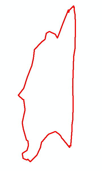

DanPatterson_Retired
MVP Emeritus
as for the buffer by area and since you have greatly generalized the boundaries,
  • calculate the area of the generalized shape
  • do a negative buffer by a small amount
  • recalculate the area of the result
  • recalculate and repeat
I am sure there is an iterative buffer by area on GeoNet somewhere, the ones on the scripts site are more for point data

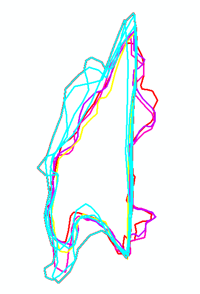

this is what the client asked for..
We require an ‘average’ outline of the wetland, but more towards recent years. Perhaps make a union of all polygons and keep 80% overlap and toss out the outlier(s). Smooth out the polygon.
This is all the information I have besides the 5 polygon shapes I have
TinaKwitkoski
these are the selected  polygons,
and this is the Merge of them
