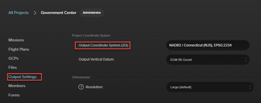

You can set the output coordinate system within any project.  Go to "Output Settings" Then "Project Coordinate System-->Output Coordinate System"

As @Andrew-Bowne stated, you can then choose your desired output coordinate system in the Site Scan project settings.
I'm not an AutoCAD Civil3D expert, but you should also be able to define your TIFF files' coordinate system so that it's placed in the right location. If you did not define an output coordinate system, your outputs are processed in the local UTM zone for your area, you can see it at the bottom of the processing report.
