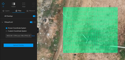

Hi everyone, I have a question about Site Scan. I am trying to overlay a surface loaded in LandXML format with the elevation products generated in Site Scan as indicated in the Cut/Fill tool documentation (https://support.esri.com/en-us/knowledge-base/how-to-use-cutfill-measurements-in-site-scan-manager-f... ), however When I load the surface, it appears as follows:

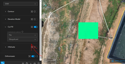

but when selecting it as a comparison surface, it does not allow me to make the intersection using the Cut/Fill tool:
Is there a workflow or can you tell me what characteristics the surface in LandXML format must have to perform the intersection?

Hi @cdanielvarons If understanding you correct - I have seen the same and reported it as a bug. The trick ("workaround") is to have 2 LandXML files to choose from (a default stupid one or a copy of the one you have uploaded). Then you get to choose from LandXML surfaces and the calculation will start
best

Thanks for "the trick"!
NicoBonnafoux
@Pål_Herman_Sund 's workaround is the current recommendation. Our teams are working on fixing this.
