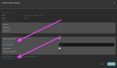

NicoBonnafoux
@tempLeidyGarcía@Pål_Herman_Sund
Thank you for your feedback. As the Reality Engine in Site Scan is still in beta, it would be helpful to our team if you could use the feedback form shown in the processing menu to share these ideas and any other comments you may have regarding the beta.
Thanks!
NicoBonnafoux
Status changed to: Under Consideration
Pål_Herman_Sund
Many thanks for  @NicoBonnafoux I shall use the feedback options but keep posting here as well.
