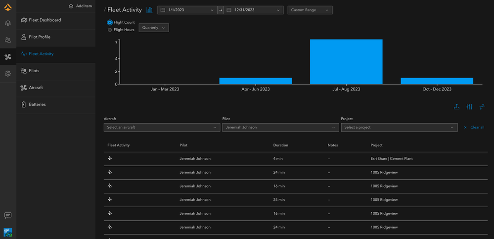

  1. Log into Site Scan and open fleet management. You must be a Fleet Manager to export fleet data.
  2. Open the list page of what you want to export. For example, if you want to export flights, click Fleet Activity.
  3. If exporting flights, specify the date range you want to export flights for.
  4. If exporting flights, specify the Aircraft, Pilot, or Project you want to export flights for.
    Use date and attribute filter options to narrow down the flights you want to export.Use date and attribute filter options to narrow down the flights you want to export.
  5. When you are satisfied with the filter options, click the Export button at the top of the table. Screenshot 2024-06-05 at 10.45.00 AM.png
Within a few seconds, the .csv file will be available in the downloads folder.
Note: the export file will always contain the same metadata fields regardless of which columns you have chosen to show/hide in the list user interface.
