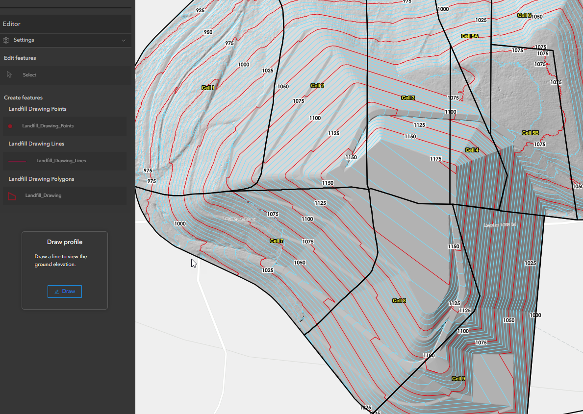

I created a 2D Experience Builder web map of our landfill using orthophotos, hillshade, colorized surfaces, and contours.
Example photo:

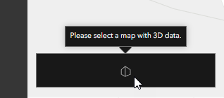

As I side note I tried adding these tools from experience builder but they all said "please select a map that contains 3D data":
