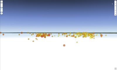

We are trying to make a presentation of registered earthquakes in Denmark since 1954 using 3D feature points in a local scene. The points are showing their registered magnitude on the Richter scale at their depth, but unfortunately the scene only allows real world units for the vertical axis, so all the points are clamped to the bottom of the terrain. This is really a shame, that there are no options for vertical exaggeration like in ArcGIS Pro. We understand that it would be heavy to display for global scenes, but why not for local scenes, knowing the fact, that it is always difficult to show features at vertical depths at larger scales.

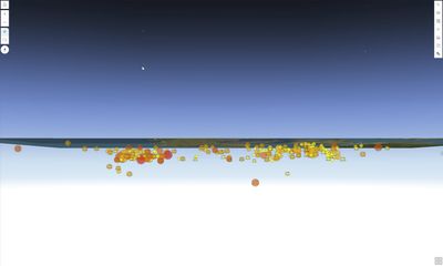

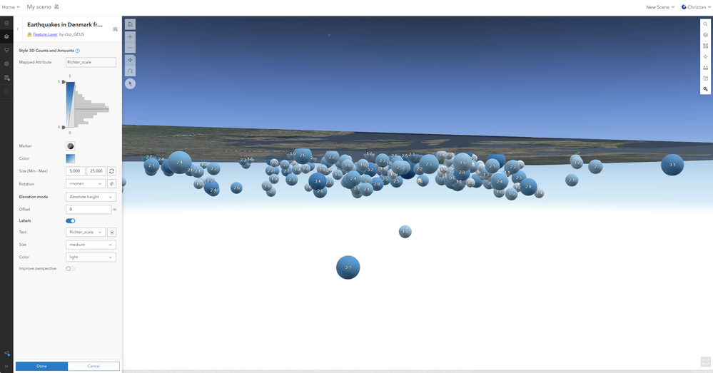

I tried to set the elevation properties of my layer to Custom as you suggested, using the link you provided. I couldn't get the featureExpressionInfo to work and if I tried with just the Geometry($feature).z * 10, it got validated it, but nothing happened. Instead I extracted the z-value as an attribute and defined the layer elevation using this expression instead, $feature.Depth_km*10. This works in ArcGIS Pro, but when I share the layer as a scene in AGOL, I get the same result as before. I even tried with a factor 100 and has an effect in ArcGIS Pro, but not in AGOL. The Elevation mode is however set to <<custom>> in AGOL.
$feature.Depth_km*10$feature.Depth_km*10
$feature.Depth_km*100$feature.Depth_km*100
