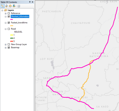

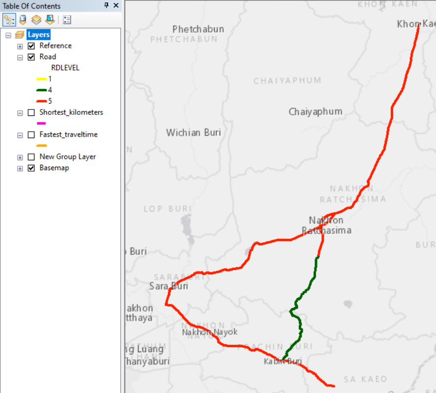

I set the priority of a road from 1 (low) to 5 (high) the picture below
I'm routing from point A to point B using 2 methods.

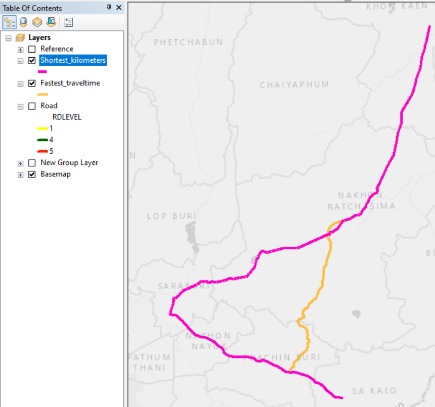

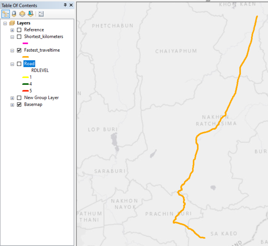

1. Route1 point A to point B: impedance = Travel time (find fastest route)
    result: 377.89 kilometers // 265 minutes // routing through road level 4
2. Route2 point A to point B: impedance = Kilometers (find shortest route)
    result: 512.16 kilometers // 345.97 minutes // routing through road level 5
My question are "why the route 2 takes distance and time more than route 1?" and "Is the result from route 2 should be the same route or close to route 1?"
DavidPike
MVP Notable Contributor
I won't pretend to know much about the heuristic algorithm but I do think the hierarchy is causing the strange results in even a relatively simple solve.  I'd recommend analysing without a hierarchy to test this - also having a hierarchy seems counter-intuitive if your only question is which is the shortest/fastest route.
