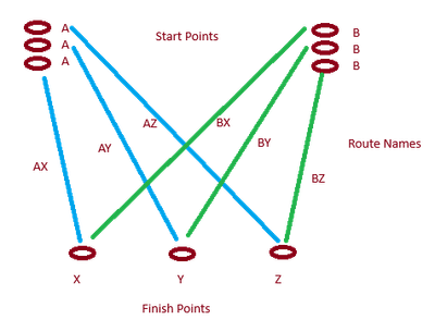

Assuming you have access to the Network Analyst extension that Dan has linked, you setup your Start and Finish points with Route Names. You need a start point to go with each corresponding finish point. Think of it like this - if you have Point A and you want to calculate routes to Points M, N & O, you need 3 copies of Point A, each with a unique Route Name that is also referenced by each finish point (i.e. Route A-M, A-N & A-O). When you run the Solve tool to calculate routes, it recognises those route names and calcs the route from A to N, then another for A-M and again for A-O. The same dataset could also then contain start points B, C, etc and other finish points, and as long as you have those start points copied and named to match each required finish location, it will only calculate those routes. It seems like a simple concept, but it took me a while to figure this out so, thought I'd share it.
Below is an extract from a python code that generates the Start and Finish points based on 2 input datasets (the start points actually being polygons so you can see the dissolve and conversion steps added in to deal with this). The code goes on to solve the network too, but I haven't added that as I haven't got it running properly in an automated manner (which is how it is supposed to run). I have a model that does this too for users to use in ArcGIS Pro (what I used to build the below code in the first place).

_rows = static_destinations
    )[0])
    print("Static Destination count: " + str(DestinationCount))
    TargetCount = OriginCount*DestinationCount
    print ("Target Count = " + str(TargetCount))
    # Iterate through Origins to replicate points for each Destination
    print ("Start iterating Origin points to create 1 set of all Origin points for each Destination point")

LindsayRaabe_FPCWA
MVP Regular Contributor
Yep - it's just the Network Analyst extension as you've shown. I do most of my python work using IDLE or within Pro itself. I've never used Jupyter Notebooks or Visual Studio Code.

Lindsay Raabe
GIS Officer
Forest Products Commission WA

LindsayRaabe_FPCWA

Dale_Honeycutt
Once you have the Network Analyst Extension, take a look at Closest Facility Analysis.  Your provider would be the facilities and the clients would be the incidents.  Set the problem up so that clients are traveling to the facilities and you set the number of facilities to find to 1 (one).
Jades1
Yeah, I've used finding nearest point in AGOL, but I thought it was really solving the problem of one location to many (since all providers are at different locations). I will look through closest facility in more depth and let you know if I have questions. Thanks!
Jades1
Wouldn't this just be finding the closest provider though? Vs the actual distance to each client's provider (which may not be the closest provider?
Dale_Honeycutt
My bad -- I didn't catch that you already had the provider-client pairs.  You can find the paths between them using the Route Analysis solver.  Each stop (the point to visit along the route) can be assigned its own unique RouteName.  The solver will create a shortest path for each unique RouteName.  So, just give each of your provider-client pairs a unique RouteName.  Set the client point as the route origin (sequence = 0) and the provider as route destination (sequence=1).  Of course this means you'll have to duplicate points for the providers, one point for each client assigned to that provider.  It seems you know Python pretty well, so maybe write a script that takes the provider-client pairs and their locations and outputs a point feature class with two features for each pair along with the RouteName/Sequence. (This would be useful code to share)
See https://pro.arcgis.com/en/pro-app/latest/help/analysis/networks/route-analysis-layer.htm for more information on the different settings for route analysis.
