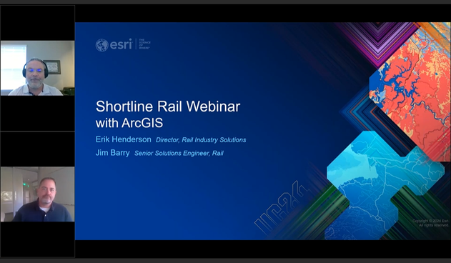

On August 29th, 2024 we at Esri hosted a webinar focused on how Short Line railroads can get started, and get productive, with ArcGIS.  We discussed how to start building your GIS database using data published by the ArcGIS Living Atlas and by the US Dept of Transportation's Federal Railroad Administration (FRA) mapping portal.
Here is a link to the recorded video of that webinar in case you weren't able to attend:
https://mediaspace.esri.com/media/t/1_9w18zlsc/238782693
