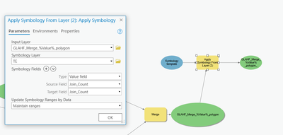

So when Applying Symbology from Layer template in modelbuilder it does not work (model runs fine but output shapefile doesn't take the template). But taking the same output shapefile (GLAHF_Merge_%Value%_polygon) and running the tool in mapview works perfectly with the exact same parameters. Any ideas why this is happening?

The symbology is saved in a layer file (*.lyrx), not in a shapefile.
Do a Save a Layer File  before applying symbology from layer. These layer files will be the input layer for apply symbology from layer. The input layer files' symbology will get changed.
