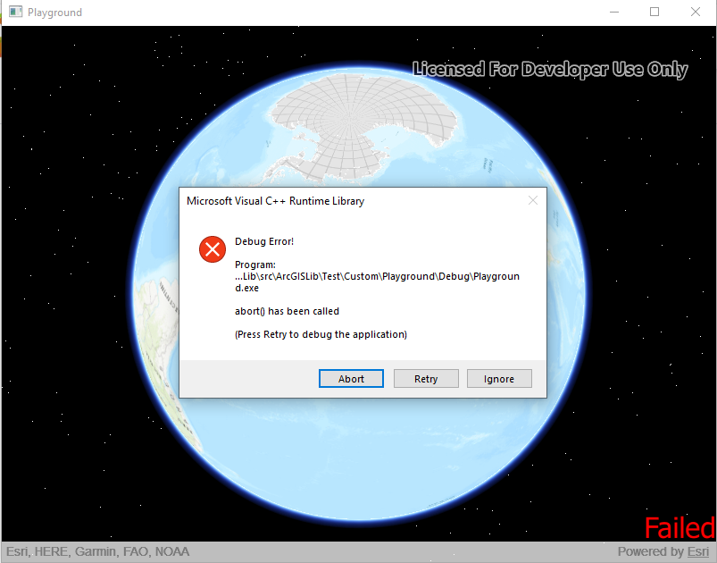

When the crash happens we get the following
Clicking ignore causes the application to crash.

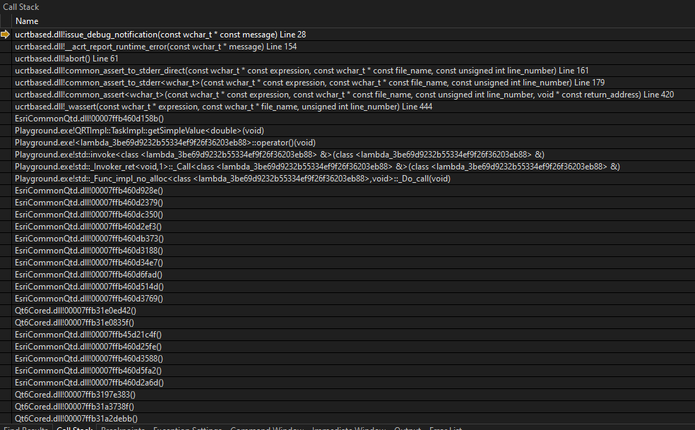

QML Debug Window:
Assertion failed: e && e->get_objectType() == QRTElementType::QRTElementType_float64, file ..\..\qt\common\qt_common\Core\TaskImpl.cpp, line 265
