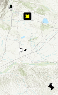

The end result in Qt Maps SDK looks like
As you can see, the 2 last symbols do change the size and color according to the arcade script, but not its CIMSolidStroke's Width.
Using the exact same style in ArcGIS Pro results in following symbols:
Here we can see that the CIMSolidStroke width is being changed according to the arcade script.
Is changing the CIMSolidStroke width via arcade simply not supported yet in the Maps SDK?

GuillaumeBelz
Hello,
We confirm we can reproduce this problem. This will be fixed in the next release. There are not workaround for the moment.
Thank you

GuillaumeBelz
Hello,
Thank you
