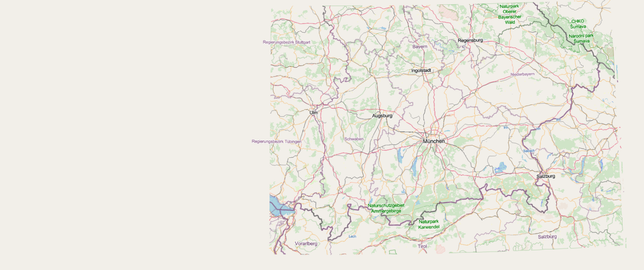

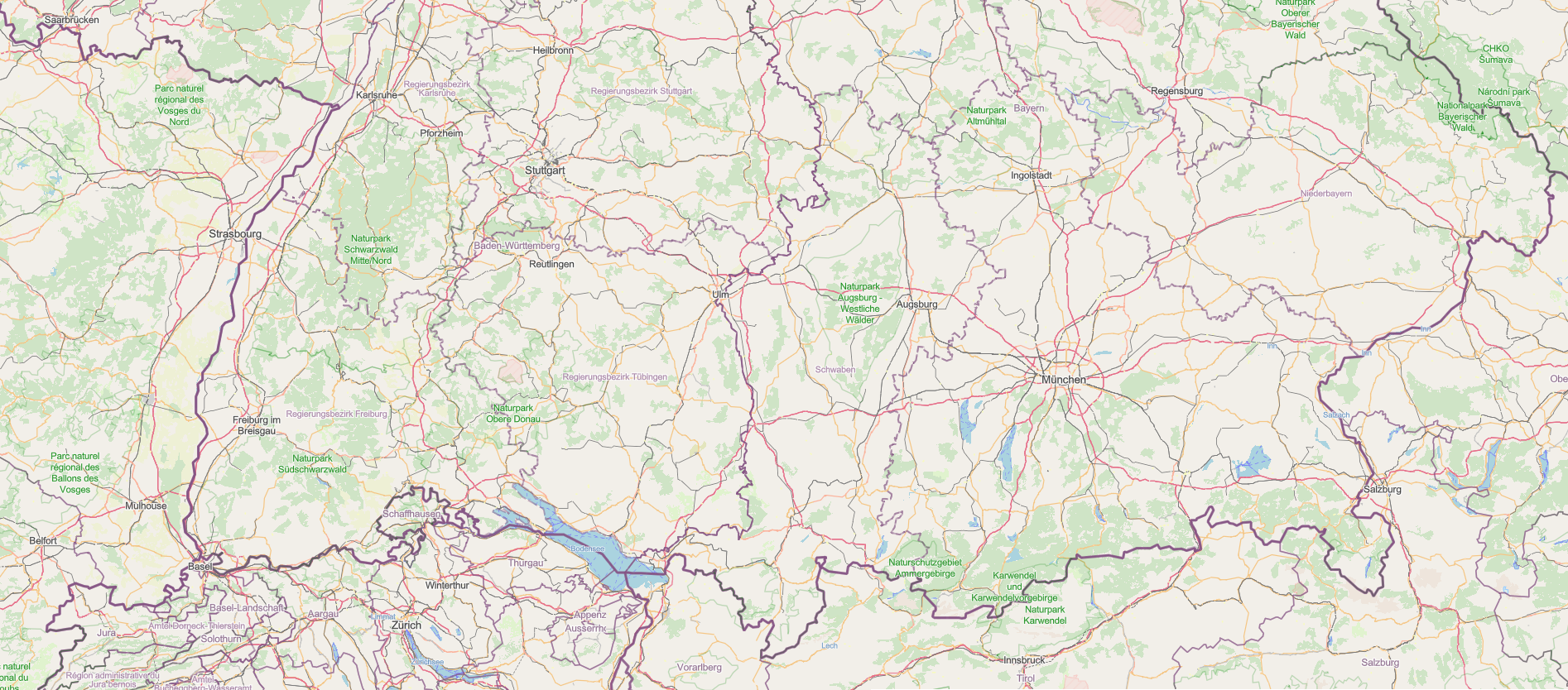

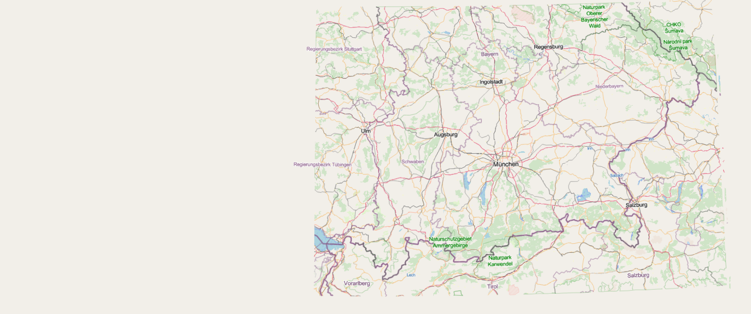

Result:
Scene View (only one vtpk is shown)
MapView (all vtpks are shown)
